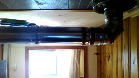

This is the picture of the current install. If there was a loose connection somewhere higher (in the chimney where I can't see) would that cause smoking in the house? It's as if the smoke isn't going up and pooling in these pipes, but the blower is working just fine, so it should just go...

From the pics,it looks like you do not have the OAK installed?
Shouldn't matter if it ran fine without it for 2 yrs though.
