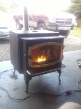

Also, here is a picture of the pellet stove. Definitely not done with it yet. Had a small storm last night so I turned it around and we sat and watched the stove and the small storm.

Stove looks good. It shined up real nice. 80::F on low as a little much. Avalon should produce a lot less ash than that whole tree burner. But then again wood stove doesn't need electricity.
