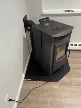

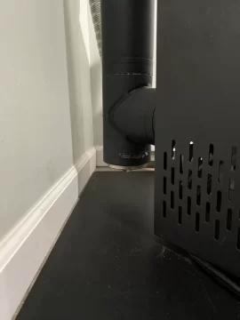

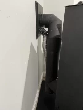

Recently swept my pallet venting all seemed well until about a day after I started burning again I noticed that there was a very small amount of fine Ash right at the bottom of the clean out which is inside of the house. I then remove clean out vacuumed it up and then put it back into place this time noticing that I was able to move it up a little bit further which told me that initially I had not replaced it correctly. As a small test I lightly hit on the venting with my hand a couple times and once again noticed that there was a small amount of ash coming out of the very bottom of the pipe. I noticed the ash was only coming out of a very small area perhaps about an inch wide on one of the parts of the pipe. To my thinking, it could be one of two things, and that likely it has something to do with the gasket which I noticed was a little bit deformed although seemingly usable. I’m thinking the other possibility could be that there’s some deformation of the actual pipe venting however this seems like a much lower chance of being the case. I’ll have to take a better look at that. That said, If I have to replace the gaskets of that clean out I believe that the venting is from Olympia and I’ve been told that their parts are only available if you’re an actual chimney sweep. If this is a simple fix of switching that gasket I’d like to be able to do that myself as I do not want to pay a lot of money for a very simple project. That said I am curious to see if generic gaskets for the sort of thing would do the trick.

I had the same issue, mine is that black pipe and the clean out has a little handle, and 2 screws securing it, the gasket was deformed and unlikely to seal correctly, I used hi temp silicon to convince it to stay in the correct location.

You wouldn't need to remove the silicone as it just holds the gasket in place, whenever you remove the cleanout the gasket stays in it, just don't take a putty knife to the gasket, just bang it out. I was surprised to see dust come out of the factory "T" connection coming from the stove as well as the clean out on mine, I used High Temp copper on the clean out gasket to keep it in place and black high temp on the T from the stove to the clean out. I have that black pipe so silver duct tape is unacceptable on all the joints, I also have a stove with the galvanized twist connections I just used High temp on the connections, but I like the look of the black pipe with built in gasket joints, just not the price.

After I pushed the clean out “cup” as far at could go, and the got the stove going. I haven’t seen any ash leakage. I will keep monitoring for now, but thank you for all the insight in the event this happens again.
