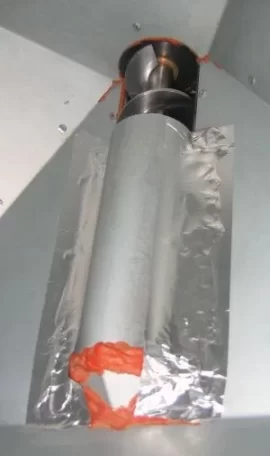

Well, just got finished doing my weekly cleaning of my Astoria, and decided to try Shortstuff's suggestion of using the metal tape over the screws. The Astoria has sheet metal screws that hold the auger flight in place, plus silicone to seal it. In general, the pellets seem to slide pretty well, as the side of the hopper are pretty steep, but I figured, "hey, what the heck".
I had some Hi-Temp foil tape from re-doing the exhaust flue joints on the oil burner. I went over the whole hopper with 00 steel wool, vacuumed it, cleaned it with rubbing alchohol, and put 2 strips of the tape over the holes as smooth as I could.

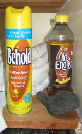

Then, I figured I shouldn't do a half-a** job, so I was all ready to go to the garage to get the car wax, when the light bulb went on in my head...... I headed for the cleaning closet, and lo and "Behold"....Behold!!!!! That's right everybody, I used furniture polish, and let me tell you, the metal is as smooth as a baby's butt......and the stove smells good too!! :lol:

  • [Hearth.com] Pellets not sliding well in hopper...REVISITED...LOL  W/ Pics!

Personally, I think the spray furniture polish is better suited.....it's meant to be sprayed on, rubbed in, and then wiped off, and then it dries.
In all of my stoves I use spray graphite.
have to re-treat every 2-3 years. no problems.
