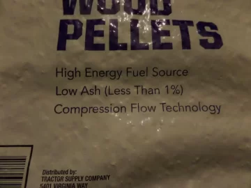

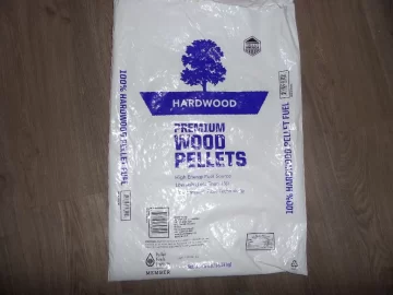

They have their own bags with their name but someone else makes the pellets. Last I heard it was Lignetics pellets in the white bags with blue letters at TSC.
What brand stove are you using?
I ran the UPC code on the blue bags at our TSC out here in southern Wisconsin and it indicated Ozark Hardwoods. So, not surprisingly, there are regional differences.
