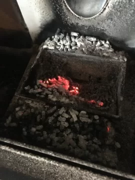

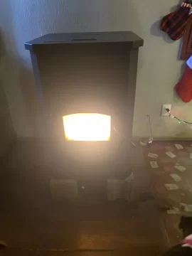

Hey everyone. So this year I installed the pp130 in our house. I have it vented through an exhausting flu with 4" all the way up. I also have an outside air kit installed. So first ton of pellets. It was doing awesome. We vacuum well every day or two. Near the end of that ton the convection blower started to whistle so I deep cleaned it and reinstalled as well as cleaned the flu Tee clean out, and it worked great for about 4 days. Then all of the sudden the flame got lazy. Started seeing black building on glass and inside of stove. And the burn pot seems to be overfilling often. I tried adjusting the dial on the stove that I believe adjusts the auger speed. But when I adjust it down. My flame gets really small and it doesn't put out much heat. So I'm kinda at a loss on what to do. I am including pics of the burn pot. This was vacuumed yesterday. A video of flame also
The stove was burning about a bag to bag and a half a day. Now it's 3.5-4. Ideas??

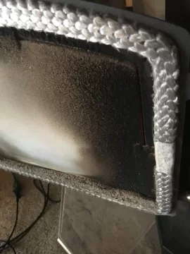

Usually a lazy flame , black build up on glass and overflowing pellets
indicates a lake of combustion air . Check air intake (OAK) exhaust
passages in stove and clean vacuum . Check and clean combustion motor
Clean chimney . Do a leaf blower clean if you have one ,
Note ash can hide in some strange places

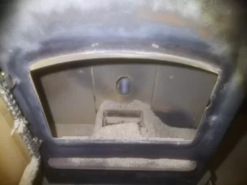

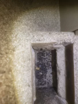

So I just pulled the panels on inside of stove and the exhaust outlet did have quite a bit of ash that I couldn't see without pulling panels. Just pulled all panels and vacuumed. Fired back up. Will update in a bit.

Did you ever get this issue resolved? I have the exact same problem with one I have installed in my garage. I vacuum it out daily and pull the panels out once a week. I also clean the "T" on the back of the stove about once a month and pull the combustion fan about twice a season and clean it out. If I leave the stove on any setting above the very lowest setting on the dial it will overfill the fire pot over time. By the time it uses a full hopper of pellets or close to it, the pot will be full as well and the entire bottom of the stove will be full of unburnt pellets to the top of the fire pot. The trim dial seems to have no affect on how it operates. In my opinion they needed a combustion motor with a little more output capability, I think it is a design flaw that their ego does not allow them to remedy. I have my stove 2' off the floor with a 5' upright 3" chimney pipe coming off of a "T" on the back of the stove to a 90 on a 3' horizontal 3" pipe that takes it through the wall to the outside.
If you are 100% sure its clean I’d have to say theres a problem with the control board, particularly the trim pot (heat adjustment) or the prom program has been corrupted.
I agree that most of the time this behavior is due to air flow issues, but bad pellets can create a ton of ash and soot that will block air flow very quickly.
I have a PP130 that I have had this issue with occasionally. For mine it is a combination of keeping it clean (especially the exhaust venting) and the quality of pellets I burn. I got a batch of off brand pellet a little while ago since they didn't have what I usually get. They produced a bunch of ash and would fill the pot/stove/vent extremely fast. They also deposited black soot all over everything. This caused failed ignition sensing, lazy flame, etc etc.
I am now burning Lignetics hard wood pellets and no longer have this issue. I usually turn the stove off and dump the ash out of the pot every 1-2 days. I pull the interior panels and vacuum everything really well about once a week. Once a month I clean the vent piping and I pull the combustion fan to clean it about once a season.

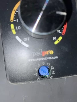

The trim doesn't adjust the pellet feed - it adjusts the amount of combustion air from the variable speed combustion blower. Try turning it up to a higher trim number to get more combustion air into your burn pot. The more difficult PP130 we have needs a +3 trim setting to burn cleanly, while the other burns like a champ at -1/2.
Also, you mention vacuuming. Do you also scrape the burn pot and ream the air holes at least weekly? If not, you may have carbon deposits blocking the air holes in your burn pot, which would also cause the lazy burn and unburned pellets.
In the manual it states that if you have a lazy flame or soot build up to turn the dial counter clockwise. I have tried adjusting it both directions but only once in the clockwise direction as I figured they are indicating that would slow down air flow. For this particular problem with pellets piling up should I in fact be making adjustments in the clockwise direction off of zero? I appreciate the advise and find this to be a good site to read and ask questions about theses pellet stoves.....
I know that's what it says, but it also says if the fire goes out, turn it clockwise. The trim adjustment isn't very well described.
On both of ours, turning clockwise increases combustion air. On the one in the shop, going too far goes to blowtorch and the tall lazy flames, so it's just counter clockwise of zero.
On the one in the house (exact same install, including pipe size and length), a neutral trim setting is such low combustion air that the vac switch trips and stops the pellet feed when it's running on low. That one needs a trim of about +3 to run like the one in the shop.
I don't know if it's a difference in the combustion blower or the trim pot, but it's not the vacuum switch - I've swapped them between stoves with no change in behavior.

I talked to Pelpro tech support today and they told me the trim dial adjusts or changes the auger feed rate as well as the amount of combustion air. They told me the negative side of the zero setting slows both down and the positive side speeds both up. I timed the off cycle time of the auger with the dial at -4 and +4 and there is about a 3/4 to full a full second difference, the -4 it was off for about 4.5 seconds and +4 it cycles off for about 3.5 seconds. I was just using a stop watch so about a 1/4 second variance is what I was seeing between results. This design probably works well when all factors are a constant but in the case of pellet stoves sold nation wide probably not such a good idea. Since they cannot control the altitude or name brand of pellet being used you would have to set you air to fuel mixture differently for different geographical locations as well as fuel, you won't have much luck just having some canned settings that turn both up or down linearly. Basically what they have on what they call a trim dial is actually a gain dial where as they can turn up or down the output of the stove in reference to the thermostat dial. I know something about fuel to air ratios because I work on duel fuel oil/gas boilers in the northern plains and rocky mountains areas and none of them are set the same on the fuel air settings to get the same desired emissions results. And all of the boilers I work on are identical name brand and size.
So now what the question is has any one wired one of these stoves so you can adjust the feed rate or air flow independently of the stove control board? If anyone has done a mod or knows about upgrading these to have independent adjustments or even if you can plug in to the control board and fine tune those adjustments on there would be greatly appreciated.
It would be nice if you adjust them separately. It makes no sense that they would increase both or decrease both. I would think that for the adjustment to be worth anything it should be the inverse. One way should increase the air and decrease the fuel, while the other way should increase the fuel and decrease the air. That way you could find the sweet spot for the air/fuel ratio to give you a good clean burn.

Little update: I turned the setting up to +1 and it burns about the same in regards to flame size, color and richness.
