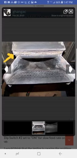

Hello, I am new to this forum. I have had the Harman PF100 for over 8yrs and I was wondering if this is a fire brick and what the replacement size is? I know about the fire brick that sits against the pf100 wall...but was unable to find this one...or am I wrong and this is just burnt pellet debris? Any help is greatly appreciated!

That is a fire brick. Here's a link to the part. (broken link removed to https://pellet-stove-parts-4less.com/products/harman-firebrick-fits-pf100-300i-oakleaf-tl300-tl2-6-ba100-3-40-86125)

The burn pot has had a bubble in it now for like 6 years, doesnt appear to hinder the machines performance. I have the occasional ignitor issue where the pf100 never lights....I recently changed the flame guide and the fire brick after 8 years. I didn't realize the flame guide was a wear and tear item. Let me tell you I spent like 2hrs trying to pull it out as it became bloated and impacted in the burn pot....nightmare!!! Look at the old vs the new. Happy Holidays!
