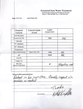

Attachment shows levels that were satisfactory, I am not sure of the upper and lower limits. Hope this helps.

This is for an Empyre Elite 100/200 indoor gasser.
Draw a water sample once a year and forward to your dealer for testing.
Water properly treated with Pro-Fab approved water treatment should have a ph level between 8.8 and 11.0, a nitrate level between 730 and 1460 ppms as NaN02, and a conductivity must be less than or equal to 4000 mmhos.
If the pH is not within tolerance, treat by adding a ratio of 1 part of Pro-Fab approved Wood Burning Furnace Treatment (WBFT) to 300 parts of system water and retest. If the nitrate is less than 730 ppm, treat by adding a ratio of 1 part WBFT to 300 parts of system water and retest. If the conductivity is higher than 4000 micromhos, drain 50% of the system
water. Refill and treat by adding a ratio of 1 part WBFT to 300 parts of system water and retest.
