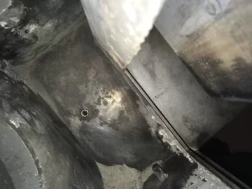

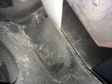

in your smoke chamber, there is a hole on the rigth hand side wall this ole is connected to the Pressure switch it is usually block.
most customers will clean he smoke chamber not knowing about this issue use a paintbrush to reach one way I do is to take a picture before and after with a smartphone look at the picture bellow. you van see the chrome ring. for the built up the auto cleaning need to be ajusted if you need furtur help contact me pmaertens@msn.com
  • [Hearth.com] Piazzetta Monia Fails during Control Phase /w status ALF 2
