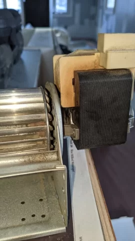

Still making the noise after an hour of soaking. Video and pictures attached.
  • Sabrina_noise_2.mp4
    11.8 MB
  • [Hearth.com] Piazzetta Sabrina popping Noise
I think I would replace the bearings
Reactions: Ssyko
I suspect you ignored the noise too long and euchered the bearings. Once they get dried out and you ignore them (noise), at some point they are junk. They can be replaced but you need take the motor apart and extract the bearings and get the item numbers off them and order new ones, Probably will be on Amazon, but Motion Industries or Detroit Ball will have them for sure and both do online sales.
At this point you only option is to buy a new fan unit and rebuild the old one for a spare and if you don't want a spare, you need to start being a bit more maintenance aware. Like I said in an earlier post, I take my unit COMPLETELY APART every spring, clean it, clean the venting, remove all the motors and drives, lube all the bearings and grease all the reduction gearboxes and then in the fall, it's good to go with no worries. I have in the excess of 15 years on my unit and I've NEVER replaced any mechanical components or bearings.

Wed all like to help but sometimes things get too far gone to fix. I would if I were you, oil the bearings on the new blower motor before installing it. Just because it's new don't mean the bearings are adequately lubricated. In the spring, pull your combustion fan, clean the plenum out and the venting, brush off the combustion fan blades with a soft brush and oil the bearings on that motor too, The auger drive motor will probably have oil holes in the outboard bearing support, oil it and put a drop or two on the gearbox side as well.
In retrospect, I believe the noise you were hearing was the motor armature hitting the field laminations because the bearing were wallowed out and were allowing the armature to contact the motor frame. It is repairable so if you have time, repair it and keep it for a spare. You never know when one will fail.
