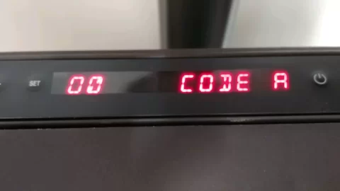

make a reset on a Sabrina Model go in menu> menu parameter> set> data bank> O0 is the code you need Letter O and number 0 then> set ; it will show data loaded you will need to do the basic configuration languag, hour, etc....
Reactions: chken
Merci for trying to help Pascal. I was thinking the same thing, factory reset. But I did not have the instructions.

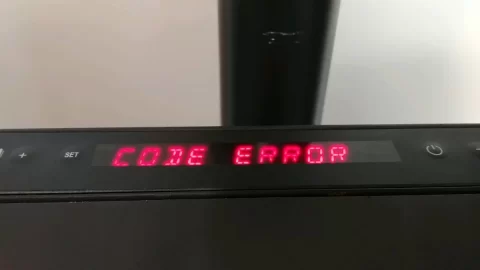

I got to the menu and put in Code O0 (O AND ZERO) BUT i GET A CODE ERROR. Is it possible there is another code? This is a 3 or 4 year old Piazzetta Sabrina. ....I had another code, F%, to access another part of the menu. I'll try that also. I have cold checked the auger, fan, etc and they all seem to run. What is wired in series that is not closed that would prevent a try for ignition. It doesn't fail ignition. It just won't try. It is 0 C here this AM. Merci, Merci, Merci! Bonjosan

give me your ORD and Matricule number next to the barcode

Says "DATA LOADED"
The just reverts back to "TIME / OFF"
or if I push any button it reverts to "TIME / OFF"
Thanks!
Sorry for my mistake. Thanks for spending part of your Saturday helping us.
I am confused where to go from here. Seems like other options require codes also.
Got to DATA LOADED and stuck. No change. If you have time later, appreciate your wisdom. Bonjosan
