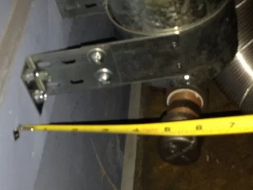

The straight lengths came in black but the paint was chipped during shipping so the guys repainted everything in the morning so it would match. They did not use any support straps because they felt the cathedral support mounted on the rafter and the 6" screws in the roof would take the majority of the weight. Should I put a couple on at the tee and midway up? the pipe is 8" from the wall

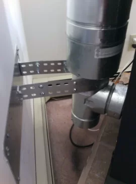

I would still recommend atleast one support strap in this case. If the stove is disconnected for service, then there would be undo pressure exerted on the venting that could cause damage to it.

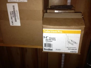

The 4" diameter strap extends to 5-1/2" from the wall to the center of the pipe. There is however an extension to extend it another 5-1/2" max. So this would probably do it.
The last pic shows the extension install with the plumbers plate that I have done.
You can paint the plate and straps black before the install for good looks. I also recommend 2-1/2" wood screws to get the plate into the wall studs securely. Let me know if you need any of these parts.
I also like to use washers and lock washers on these support straps. It just makes a much more secure job!

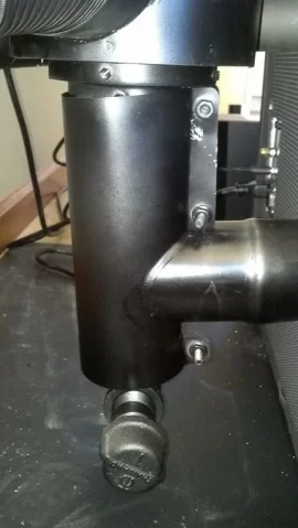

There is a shroud clamped around the tee in the pic below. Should it be taken off to put on the support bracket or left on?
[Hearth.com] Piazzetta Sveva Install Thread
That is interesting, You would not need the shroud with the support bracket. Therefore it should be taken off.
