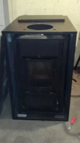

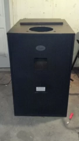

Pics as requested. I still have to install the thing...run the venting and the duct work to the existing furnace. It's going to be fun.

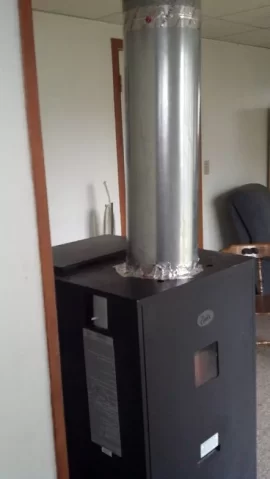

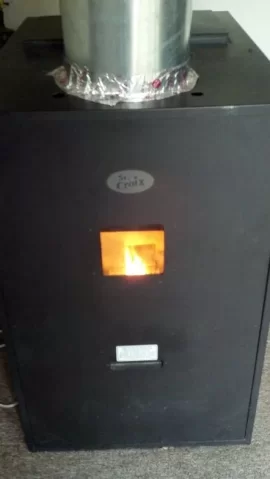

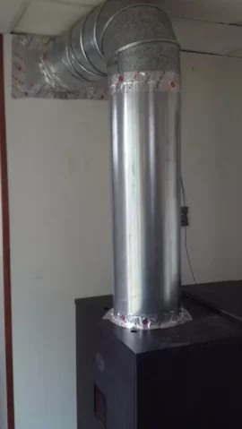

Pics as requested...

Install looks great. Congratulations. Hope it serves you well for yrs to come.
