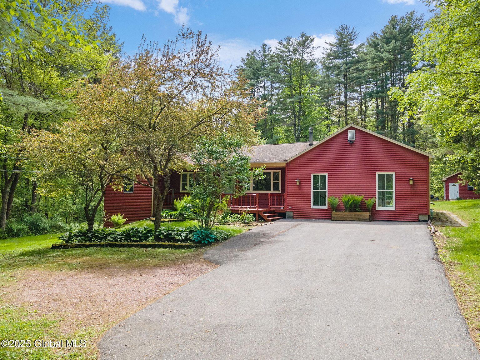

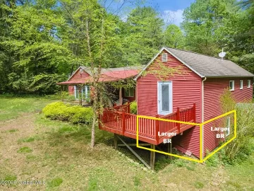

I'll go even one better... here's the link to the real estate listing...

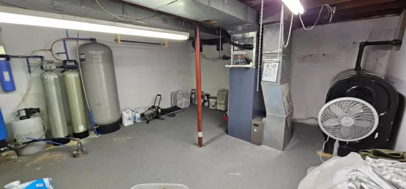

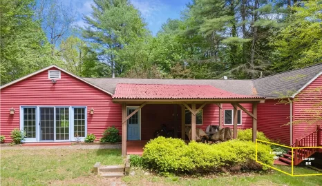

As you can tell from the listing, the property slopes from back right to left front. The family room/pellet stove are on the right side of the house, and the rooms in the basement start on the left side. Even though the family room is sunken (3 steps down), it still sits higher than the basement. The walls are concrete block.

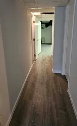

The basement is comprised of one larger bedroom (24) and a tiny bathroom (27) on one side (toward the back of the house), and the laundry room (22-23) and smaller bedroom (26) on the other (toward the front). A narrow walkway (attached) between the two sides leads to the room where the furnace, oil tank and water filtration system is (also attached). The back wall of the furnace room is directly underneath wall that separates the family room and the rest of the house.

Ok, that’s not at all what I was picturing!

Thank you all for the replies! Even my father-in-law, who's a retired carpenter, suggested a mini-split heat pump, which is what he has in his TV room (a converted one-car garage). I'll be reaching out to a couple local HVAC places this weekend/early next week.
One thing I forgot to mention is that, unlike the larger basement bedroom toward the back of the house, the small basement bedroom across the hall has no windows, as its front facing wall is mostly embedded into the ground. The larger bedroom has some embedding, but has a window, and more overall wall exposure to the outside air on the left and back sides. (see photos). Plus the floor area in the smaller bedroom is only about 90-95sqft (<8ft x <12ft).
As a result, I've been told that the smaller bedroom (where a teen sleeps) hasn't been getting nearly as cold as the larger one is. Thus, it seems like I'd just need the one mini split for that larger bedroom (where an adult sleeps).

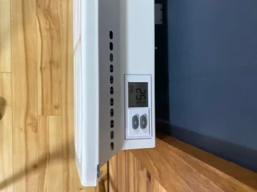

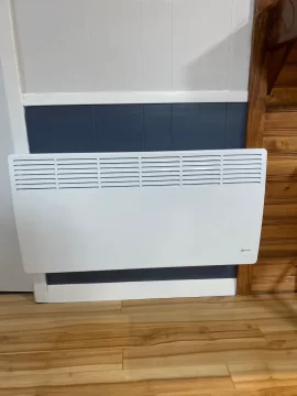

If you have some extra electrical panel space (enough for a double pole breaker, 20A) you can just get some convect heaters. I installed this one in my basement next to my pellet stove. They are inexpensive, built in thermostat, and multstage heat output. With the bedroom doors closed they will heat the room no problem. I have two mini-slits, and when I got here one was in the basement. I could not use the cooling function/dehumidify at all in the summer as it never got over 21C down there. I moved it to my bedroom where I love it. It is now heating and cooling my main level. I think mini splits are not going to supply the heat properly when you really need it as they frost up. I use mine when it's warmer than -5C or so then keep the pellet stove going full time. I still think you could use your furnace but ifyoyu don'tneed to heat the entire basement I'd just keep the fan on all the time and circulated your upstairs air by partially closing off the basement air return.
