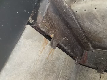

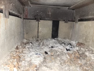

The Pacific Energy stove that's shown was a good one and much safer. This one is old, but the design was solid and parts are still made for it. What is its condition internally?

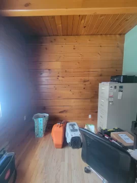

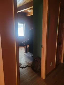

Just supposing here. What is at the main floor interior location of the exterior chimney pipe that connects to the basement stove?
I'm thinking another option would be to raise the tee to the first floor and run it through a thimble at that location. Then connect the PE stove there. If possible that might be a much less expensive option if the PE stove is in good working condition.
That interior location is our office room. Its pretty closed off from the rest of the main living space.
Husband thinks that if we put a stove in there we would have to start tearing walls down to heat the main floor adequately.

He's right. The stove is an area heater. It belongs where the heat is most needed and welcome.

Great. Given the age of the PE stove, if its connecting pipe is the same age, I'd replace that chimney pipe with new. It's likely is decades old and could be hard to impossible to find mating pipe now.

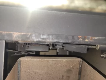

Barrelstove69, can you post some pictures of the interior of the PE stove?
Reactions: BarrelStove69
Here are the photos, as per request!
  • [Hearth.com] Basement woodstove, backdraft, carbon monoxide
