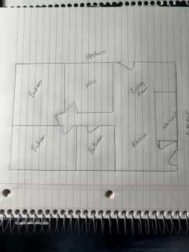

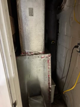

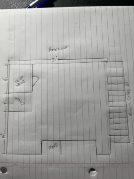

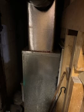

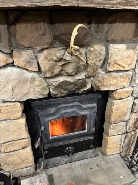

Yep basement walls are insulated with the exception of behind the stove. Ceiling is not insulated, and we currently get really nice radiant heat through the floor. I've added a basic layout of the house and pictures of the setup. Basement is almost completely open except for a bathroom and small storage closet that I omitted where the water softener is. We always keep the stairwell door open for our cats to get downstairs and for the dog to clean up the cat food.

I am heating a 1700 sqft + 825 sqft basement with a basement stove with a slightly larger firebox (2.9 cu ft vs 2.4 for the Osburn). Insulated basement (and rim joists!), R13 in the walls upstairs, excellent quality windows, and R57 in the attic.
But the Osburn likely has a larger heat output (than my cat stove) - meaning I think you'll be fine with that size stove in that size house, but you'll have to reload a bit more often than I do. (Last night it was howling and 17 F, and I got 11 hours out of my load of red oak).
Regarding passive heat transport, that works best if you have a circuit of air, i.e. stairs heat going up and elsewhere colder air coming down.
In my experience (but others may have a different experience), doing this passively is hard.
I did it actively - but not by pushing warm air up, but by sucking cold air from the floor of my living room and depositing it on the floor of the basement. I.e. my fan pushes air into the basement.

At 2.4 cu ft, the Osburn 2000 should do the job reasonably well. It's the fancier version of the Drolet Escape 1800 that several folks here have. Burn time will vary with the load size, draft, wood species, etc. but it should be in the 4-8 hr range depending on how hard the stove is pushed. Based on the layout the heating bias will be in the living room area. I'm not sure how the old setup is ducted but it might be adapted, off the stove at ceiling level , to help distribute the heat.

Thanks, I also was concerned with the idea of moving CO. The current setup has a plenum surrounding the entire stove with a low volume squirrel cage fan blowing hot air through the ducts. It’s on a switch and I don’t turn it on until the stove is up to temp to avoid draft issues; learned that lesson the hard way! I haven’t measured the cfm on the output, but it’s low. It will flutter paper on the vent but will not blow it completely off. We have CO detectors near the existing stove, at the base of the stairs and 3 upstairs as well. I would rather err on the side of caution though and will likely try moving the cold air down as you mentioned previously rather than hot air up. I think if I upsize, there honestly would be sufficient radiant heat. I appreciate all the thoughts and suggestions!
