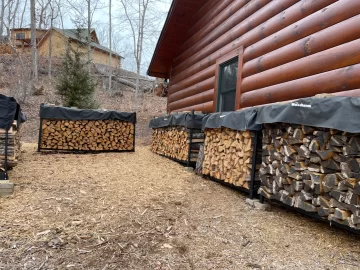

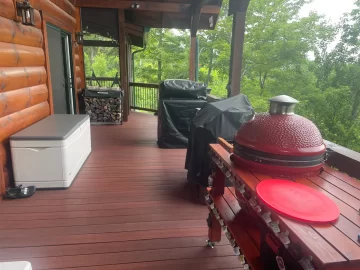

I hate gas. We had gas fireplaces in our previous houses and hardly ever used them. They just feel so blah. Nothing compares to the heat from a wood fire.
In our current house, we installed a free standing wood stove and absolutely love it. We don't use it for full-time heating, but when we do use it, we turn the heat way down so the HVAC doesn't come on. It keeps our main living area nice and toasty. We don't overnight burn but the heat does not end up coming on until early morning as the stove continues to radiate heat overnight. We live in NC so our winters aren't terribly cold.
We keep a small wood rack on the deck right outside the sliding door near the stove and use a log-carrying bag to bring the wood inside. Yes, there is some mess, but a quick vacuum takes care of it. I'll bring in the wood, load and set up the stove, vacuum, and then light it. If we're expecting bad weather or a really cold snap, I'll bring in extra wood and keep it in a tote next to the stove.
We don't have a lot of room for wood storage because we're on a mountain with mostly sloped land. Fortunately, we have a flat area behind the garage, so we bought covered wood racks for storage.
In the nine years we've lived here, we haven't had to pay for wood. We had trees come down during ice storms our first few years, so we processed those. Yes, processing your own wood is work! In the beginning, everything was split with an axe, which my husband had to do because I just couldn't wield one. Most of our wood is oak, and it is so hard.
After Hurricane Helene came through and we had so many downed trees, I finally ordered an electric wood splitter. It made things so much easier, and I wish we'd bought one years earlier. My son and I were able to do all the splitting ourselves with it.
And dry wood is extremely important. Our first year, we actually got properly seasoned wood from a friend of my husband's because we didn't have enough dry wood of our own. You definitely have to stay ahead of your wood supply so you always have dry wood ready for the following season.
I was really glad to have the wood stove last winter. We were expected to have a horrible freezing rain storm with 3/4 inch of freezing rain. There was no way the heat pump defrost cycle would be able to handle that much ice. We didn't want our units to get damaged so we turned them off, covered them with tarps and stoked up the woodstove. I stayed up to feed it through the night and it kept our main level warm.
With all that said...I would always choose a wood burner over gas. The ambiance is so much nicer than gas and the heat from it is so much nicer than gas.
I included pictures of our wood area and our rack outside our slider just to give you ideas.
Your outside looks like our dream location! I used to rent a splitter when we would have a lot of wood to split....made me question if I actually saved any money doing it that way, but my husband appreciated me not nagging him to split the wood.
We love where we live. Nice views, trees and neighbors not on top of each other.
I have no idea how much it costs to rent a splitter but the splitter we bought was $260 which I didn't think was too bad. We have used the heck out of it and its still going strong. We put some big rounds on it and I thought for sure it wouldn't get them split but sure enough it did. There is no way all the wood we needed to split was going to get done with an axe.
