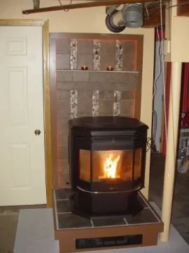

Pics of my new stove!
Its A haman P-61A......just got today so we will have to wait a bit for a review....the longer the better!!
I would fire it up to make sure it works though before fall gets here.

Hello Dale
Looks really nice! You will love those freezing cold nights now because instead of turning up the oil and thinking about the cost, you will be warm and cozy with the cheap but warm pellet heat!!!
  • [Hearth.com] Pics of my new stove!
Very Nice.... Good looking stove. Nice OAK set-up..
Is that electric Dolly yours?? Or the Dealer's?? I have been looking to buy one of those. The guy who brought my 750 lb Vault, did it with his 11 yr old daughter. His was a little bigger (More complicated) unit. But that one you have, is what I am looking for.
great stove and great looking set up. congratulations.
what pipe vent kit is that? who makes it?
vinny
That was the dealers rig....
