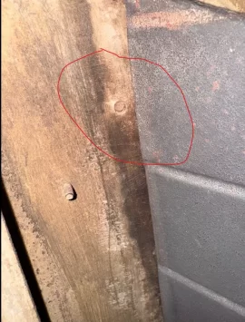

Looking for any recommendations or if anyone has had this issue. The bolt on my pellet stove which holds the bracket to hold my walls in place snapped off in the hole. I've tried drilling it out, melting it, hitting it with a hammer and nail set. I can't get the broken piece out. Any suggestions?

Thanks for the ideas I'll give it a shot, I've never heard of an easy out. I did try drilling with a smaller bit but the drill would drill. it didn't make a dent in it but I may just need a better drill bit than what I have.

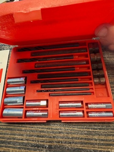

This is the kit I have
comes with centring guides, drills and non-flaring extractors
Not cheep
Not cheep
Nice Kit. I just spent 10 minutes looking for mine. I have a small one that I've had for 40 years. I guess I'll find it at some point.
