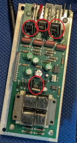

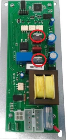

Probably a shorted triac on the board the only two I can see are circled there should be 3 legs on these. Should be continuity between only two legs when stove is unplugged. If you have continuity between all three legs then that is the triac that is bad. Triacs are like on off switches sometimes they short off and sometimes on. With moderate soldering skills they can be replaced. Is this your board pictured below 250-00011 Video on triacs not your board but good explanation of triacs and how to replace

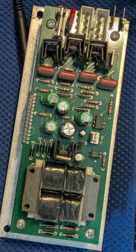

Looks like my board only has one triac, but with the board disconnected I'm only getting any kind of continuity reading between the first and third pin, no other combos.

Could you post picture of your board I see two on the replacement board picture and possible one more laying down.
