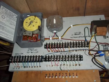

Moved to the boiler room, but retained link in the hearth forum so that a wider audience can participate and benefit from this thread.
Zones can be heated, off, or on freeze protection cycle as selected by row of toggle switches at bottom.
Timer activates freeze protection zones every so often according to timer wheel program.
--ewd
