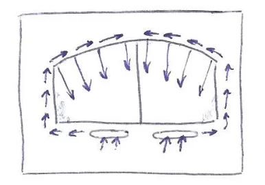

My inlet air comes in directly under the doors/windows, goes up each side through a 2"x2" square tube and out through an arched tube over the glass. Most new stoves seem to take the air wash air out pretty early, too. Secondaries are more critical on the pre-heat - you definitely don't want to cool the combustion gasses any more than necessary and if you can actually heat them up more, all the better.
What does seem to be important on the air wash is getting a good laminar/smooth flow covering the entire glass. You basically want a curtain of clean air to keep the smoke separated from the glass. If the glass does happen to get sooted, a hot burn + the fresh oxygen will help burn the carbon off the glass and you're left with a light white residue which wipes away easily.
I ran into a bit of trouble because I followed the arch of my doors - the air jets come straight out of the holes in the wash pipe, so as the pipe curves, the jets are no longer pointed straight at the bottom of the doors and I sometimes get a bit of soot in the lower / outer corners. But that has been mostly eliminated by drilling a few more holes. To sum it up in a very rough sketch:

Thanks Cozy, good ideas there. Are you using the air-wash as primary air, or do I need to think about another location for an air source? On your drawing, did you build in some sort of flow ccontrol? Thanks, I'll check in tonight, need to be workin', not lurkin'! ;-P
brokeburner - Yes, I think if you had an air inlet somewhere above the fire AND had an outlet somewhere over/in the fire, then I think you might get smoke back through the outlet in that situation. All my air comes in from below the fire. I think the primary air / air wash could come in from above the fire as the outlet wouldn't be 'in' the fire enough to let smoke out. ie the air wash outlet is so close to the door opening, if smoke is getting in the air wash outlet, then it's probably coming out the door already.
Beetle - I have a second opening at the base of the fire for primary air. Though I wish I would have done the control system differently so I could control primary air completely independently of secondary air. Maybe V 2.0 will have this mod. Flow control is via sliding metal gates.
