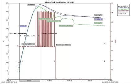

I have an STSS 822 gallon atmospheric tank which I think is awesome. I have had it running since 2003 with no problems. I made up my own copper coils and the Tarm uses two 200 foot coils in parallel. My return temperature matches the tank temperature so I believe it's close to 100% effective at heat transfer. I have tried something different this year by double loading the stove I can put in additional heat without the overhead of pre-heating the stove. I typically get 35 degrees per burn (oak) and with a 1/2 load added after 2 1/2 hours, I can get close to 60 degrees increase in a single burn. That lasts for 2 days in temperatures of 30 or above and these days close to 4 days. It wouldn't be possible without the thermal storage. I'd like to add a couple inches of insulation to hold those BTU's better.
