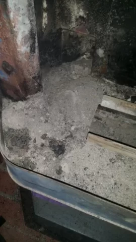

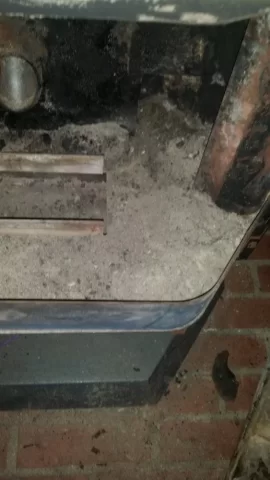

No, the auger never stops, unless i flip the switch to off, its an old analog contol with an on off switch and knobs......BUT....you guys were right!!!! Check out the pictures! I found the "hidden" chamber I never knew existed I have NEVER cleaned it in 2 years, this would be the third. The previous owner never told me about them. They were packed. Im going to vaccum it out, BUT I broke the fire brick and need to put it back together with stove cement so I wont be able to test it intil tomorrow. Ill keep you posted. Its a great stove when its running!!!

Nothing like a constipated stove and not knowing the cure. Good luck.
I am going to cast a new firebrick for mine when I remember to track down some angel hair
There is a metal shield behind the brick. There are two screws (very top, very bottom) that holds the two side shields there. They allow you to get a better shot at the two exhaust holes. I just take the scraper and bang around in there. I now have a Sears Ash Vacuum ($80) and it works wonders.

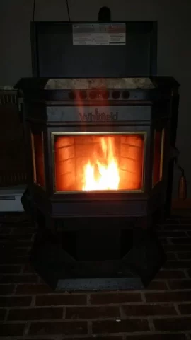

It's ALIVE!!!! You guys were right, I cleaned the chimney a month and a half ago and then the motor died. I replaced the motor and the gasket and it still wouldnt work. Cleaned the back that I didnt know about still wouldnt work. There was a freaking mouse nest in the chimney!!!! Thanks for all the help, I hoestly never would have cleaned it right without the link you sent me!!
YAY !
You probably should invest in some sort of screened termination.
