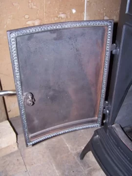

I really like the polish. I rebuilt the Defiant last year as it had the cracked fireback. This may be the third fireback in it since dad bought it new back in the mid 70's. Counting the original as one, the two piece he put in and then this one last year. First fireback was the old design and he changed it to the 2 piece fireback. On this last rebuild I decided to give all the panels a good cleaning. Decided to try the polish for the first time and I really like working with it and the results.

I looked at options and didn't want to paint it. I just didn't really want the layers of paint over the cast iron. We had never used the polish and reading about it sounded like a good option. The liquid polish goes on very thin and gets in the cracks then you rub/buff it off like waxing a car.

This is right after I rebuilt it. It took me a good while to get it really cleaned up. Not a real fun job but feels good seeing (and feeling) the results.
From what I have learned by reading on this forum it is believed that ash buildup behind the fireback is what typically causes the fireback to crack. Mine did have buildup behind the fireback when I took it apart. It is hard to clean back behind it all the way down to the bottom.
