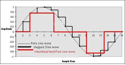

This link from Honda describes some different wave forms that come out if different generator types. http://powerequipment.honda.com/generators/selecting-a-generator
And here is a pic of modified wave forms. These visuals are great at seeing the differences. Now how certain electronics and motors will respond to each?????

I know there is a science between pure sine and dirty electric and what it could possibly happen to delicate electrical componets.
Has anybody ever had any equipment actualy damaged by a "dirty generator"?
