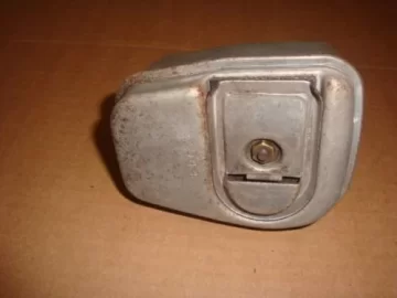

Is this your muffler? You could take a piece of sheet metal 4" x 13" and wrap/screw around entire muffler - effectively putting exhaust 2.5" in front of case chassis. Would decrease bar length 2.5". You could leave it full shroud at the top and tin snip out at 45* down to the case and get bar length back but may get more face exhaust.

Modify it!:cool: Cap current location, grind/drill hole on side and tack weld sheet metal deflector on directing gases in direction of your choosing. If this is beyond you have a friend help or do it for you. It is pretty simple if you take your time.
