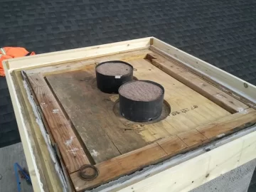

I've attached a picture of my chimney cap, right before I poured it. . .

Duratech is good chimney, go with the stainless for durability. It is possible to get too much draft but it is not likely in your situation, if you had too much draft you can install a barometric damper.
Both of those pipes are SS on the inside I believe, one is glav. on the outside, IMHO SS inside and outside is the only way to fly.
