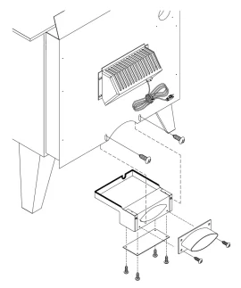

Does anybody know where the outside air kit goes on an Osburn 2300 if it can at all?
There is an outside air kit made for the stove part # AC02080.

I have the 2300 as well I'm just going to duct in a 3 inch aluminum pipe under the stove to the air intake.that fresh air intake is expensive

Two points about your idea. First, do you even need outside air? Second, if it's not positively attached to the stove, it'll just be a hole in the house allowing cold air in when the stove is not in use.
If you need outside air, try to get a good connection to the stove intake to prevent opening a gaping hole in the house. I'm sure you could fabricate a substitute for the factory kit based on the diagram, probably using off the shelf components, at a considerable cost savings.
