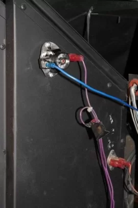

That's the one that we got. It WILL require drilling another hole to mount it, which is why I mentioned the warrantee issue. Shutting off at 70 would be really too low since you'd be blowing cold air. I have mine set so it shuts off with the steel temp at about 85. That turns it on at about 105. I also relocated it on my Castile to the upper front corner but I don't know the set up on the 1200.

what about this snap disc requires to drill another hole?
The distance between the holes is wider. You can use one of the holes but not the other one.

This is on the Castile. Using an old-school surface pyrometer, I discovered that the hottest spot on the side of the
stove was up in the forward top corner rather than down next to the other snap disk at the back.
