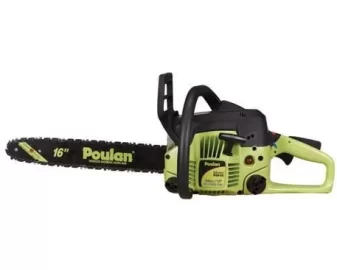

I few weeks ago I bought a used Poulan 4316. Judging from the condtion of the saw, and in particular, the muffler and bar, it looks at though it is either fairly new or hasn't been used much. It started right up and I have used it for the past few weeks without any problems, until today. Now it won't start. It won't even pop or sputter. I pulled the spark plug and it's in good condition. I checked for spark and it has a strong spark. I cleaned the air filter, filled it with gas, etc. I even poured a little gas down the spark plug hole, and then again down the carb throat. Both times not even a pop. I removed the spark plug again and it was wet and still making sparks. The piston moves freely and looks to be in good shape. With my thumb over the spark plug hole I can tell compression. I don't know how much but with it being warm out I would assume enough to get the thing to sputter. Any ideas what could be wrong with it.

I took it apart today. The needle valves were fine. The idle screw had vibrated out. From the looks of the dust on it, it may have out since before I bought the saw. Anyway, I put it back together and it still wouldn't start. So I put a few drops of oil down the spark plug hole and pulled it through a few times, put the plug back in and it started right up. So, this means I was lacking compression right? The question now is how long can I do this to use the saw, before having to really fix it? Also, what do I need to fix it? I have worked on cars and motorcycles for years, so I'm assuming a new pistion and jug. Do they sell pistions only? Can it just be reringed? Where might I find parts for it? Any high performance kits for it?

I just back from using it and it seems to cut fine. I did the drop compression test and it went down slowly and not all the way. I also had the carb off and checked the diaphram and it was fine. I also looked at the pistion wall while I had the carb off and it looked good. I was ready to give up on the thing, when I called a repair shop and they wanted 55 an hour to look at it. That's when I decided to put some oil down the spark plug hole and it give it one last chance. We'll see what happens when I try to start it tomorrow.

Today I tried it and it wouldn't start. I even put a little oil down the spark plug hole and nothing. Since it passes the drop compression test, what should I look for? Once I got it started yesterday it ran great. Fuel, air, compression,spark, and timing. I cant' think of anything else. Although, I don't have any way to check the timing on it.
