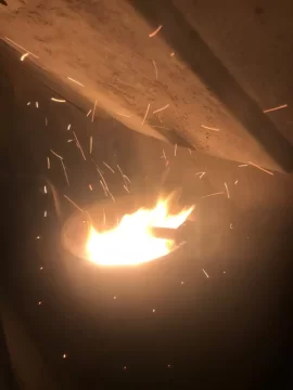

hello, we have a quadrafire 1200i, never had a problem in the past 5 years. 3 days ago it started malfunctioning. It would drop pellets, ignite, then burn out. We thought it was the thermacouple and replaced it and still the same issue. We watched a multiple videos and made sure everything was clean, including the chimney. Checked all the snap discs and wiring and everything seems to be working including the blower. Found something that said it could be something simple like our firepot gasket. Replaced that because ours was demolished. Getting extremely frustrated. Any ideas?

That was my next thought is it may be reversing. To check this you will need to empty the hopper. Put a fist full of pellets in the pot and with the hopper open start the stove and watch the auger spring and as it fires up briefly you can see if the auger is changing direction as it comes on.

Thank you. We have that a try this morning and It's going in the correct direction. We have a call out to the company because we can't figure it out and everything is checking out. Thanks for all your time and help!
