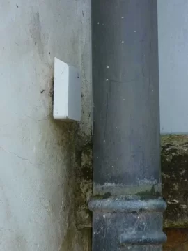

A large property I help maintain, had a wood pellet based heating system installed nearly a year ago. In that time there have been many visits by the installers to rectify various problems. There are some slightly odd things about the installation, and it would be helpful to have a second, third, etc, opinion as to whether these are normal teething troubles, or if there is something fundamentally wrong with either the equipment or the way it has been installed.
The system is controlled by an external thermostat, which has been installed on the north wall, behind a drainpipe. This is probably the coldest and dampest place on the exterior of the building. The system seems to run slightly hot. Is this standard/best practice for installing the external thermostat? Should there be interior thermostats?

John, welcome the the Hearth! First off, what brand of boiiler are we talking about? When you say running hot, what are you referring to, water temp, exhaust? What have the call-backs been about? Any pics of this system, those may help as well. I think what you are calling the outdoor thermostat is an outdoor reset temp sensor, used to modulate boiler temp based on outside temperature, and therefore building heatloss. If this is the case, the boiler temp should get hotter as the outdoor temps drop.
TS
Sounds like an outdoor reset thermometer, the outside thermostat can't be in the sun or it will make it go bonkers. There is an indoor thermostat too, the outdoor one sets the water or air temp and the indoor one controls the fan or circulator.

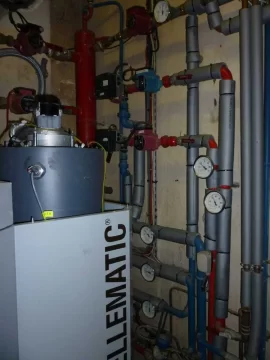

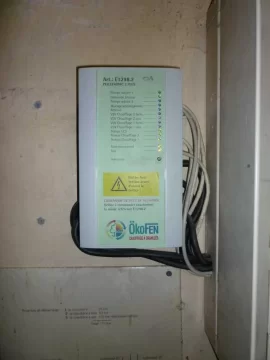

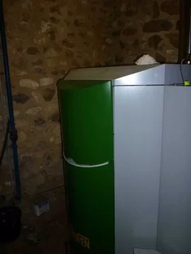

Hi,
Thanks for your replies. I have uploaded some photos of the installation, although it pretty well fills the boiler room.
Slowzuki, I would be grateful if you would explain why the thermostat would go bonkers if it receives direct sunlight. Surely if it gets warm due to the sun, it will cause the boiler shutdown or reduce heat output, which is what it should do?
Regards,
John O
