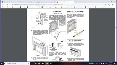

Is there an on/off switch on the surround?
If by on/off switch you mean a wall-switch: no, there is no such switch.
There is the the receiver box (?) of the RX-05 with 4 AA batteries, wired into the valve. And the remote. The receiver box has a 3-position slide switch: off-remote-on. Presently, on the remote setting, the remote will turn the unit on. Or, I can slide the switch to the "on" position, and the unit will go on. But nothing will then turn it off: neither the remote, nor sliding the switch to the off position.

Here is a page from your manual. It shows the location of the on off switch on the upper left of the surround.
