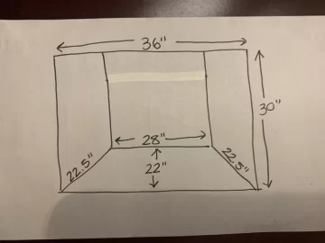

We just bought a house and looking into adding a propane direct vent insert or maybe a vent free log set. Not sure whats better for my needs. I have had 3 pellet stoves over the years but in the new house we want the ease of the propane. I went to my local heart store and they carried Heat&Glo. They were over 4K I think this is a bit pricey for a gas insert. I mean there are more parts in a pellet stove. Can anyone recommend any manufactures to look at? The Pellet stoves i have in the past where from Quad.
House
1400 SQft Colonial
I am not looking to heat the entire house just help off set some of the oil. The first floor is pretty much wide open. The house is on lake so the back of the house on the first floor is pretty much all windows.
See attache image of Fireplace measurements
Let me know your thoughts.
Thanks
Mike

As far as using it for heat i would go fireplace insert route over a gas log set. I can speak for the Kozy heat line and the Fireplace Extrodinaire line as that is what we sell at work.
The Chaska 34 and the roosevelt 34 from Kozy would fit int there without a problem but you are going to need a shroud to cover up some of the extra space around the opening. You could always do a custom 4 sided surround and that would help take some of the metal off the top but it will also add to the cost of the project.
From Travis i would reccomend either the 616 or the 34 DVL all 4 of these units are close in size kinda comes down to looks, and what you are willing to spend depending on the install and everything around 3500-4k is probably going to be a good average. Unless you were willing to do a cash and carry and install it yourself, if that is something you are comfortable doing. When we send a unit out cash and carry we go out and do the start up of the unit and look at the installation to make sure it was done properly.

I would guess cash and carry on a insert would be around 2800-3200 roughly with all the parts and pieces you would need, which include a aluminum liner and the chase top .
As for log sets they send the bulk of their heat right up the chimney versus into the room. It will warm up some of the space directly around the fireplace. plus with them not having a fan on them they dont have the ability to push the heat further into the space.
