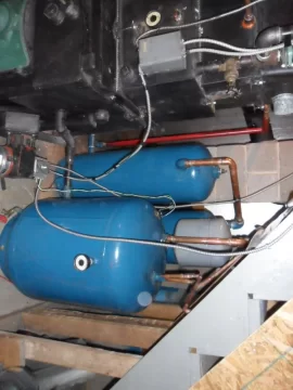

I had to put 4 tanks in also,I have 4 85gal.and two 35gal. tanks hooked up in a row,all 1 1/4 inch black pipe,first one goes into bottom [which is all returns also] and out top next goes into top but pipe goes down to bottom inside tank then a short pipe for out,get ful circulation that way,the last tank has DHW coile heat also,then back into boiler, it all works fine each tank I put a drain and air bleeder on top.And fitting for temp gauges,ALWAYS use BLACK pipe not cast fittings when welding to tank.
Wash them out good,bleach dont hurt,then fill some with water or blow air into tank while welding. This is photo of 3 other are behind boiler

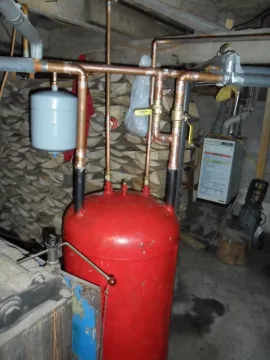

Here a tank I made for a guy you see both 1 1/4 pipes go into top but I have one going 30inch down into tank and one 6inch down,get good circulation, [this one has DHW coil] you can hook more tanks up in a loop it works fine,
