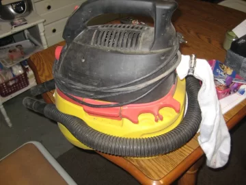

If u can, run the Exhaust blower while you are vacuuming...
this is my 30.00 Home depot homemader.[Sock/Clamp not included lol]
very light 2 gallon wet/dry.. Didn't want to lug around a 5 gallon jobber. I mean how much Ash can a stove have when u do it regularly...
took few months to fill up. Although Sock catches the dust, I wear a Mask regardless.
