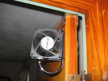

Well here is version number 1 of my home made door fan, an old (from a dead computer) 12 v muffin fan and a simple over the door hook, if it works I will look into some bigger fans and make my own mounting bracket

Sometimes the simplest answer is the best. I was looking into using a 110v muffin fan, but I knew my wife would be upset if I put holes in the wall/trim. I didn't think of the over the door bracket. Let us know how it does please. Thanks.
Pretty much looks like my set up, only I attached mine to the door jamb.

How many cfm is it?

It is in a room with 2 doors, one fan blowing in (down low) one out (the muffin up high) as I said it is from an old dead computer so I have no idea on size/ model.
Nice job on the bracket!
That is a good idea to use with the fan below.
