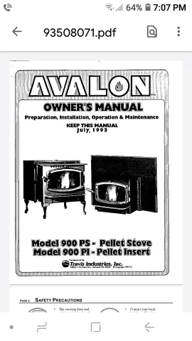

Hello I recently purchased an Avalon 900 PS stove second hand everything seems to be running fine during startup. I completely cleaned the stove but it cuts off every 15 or so minutes I am currently running the stove in a barn with minimal installation.
