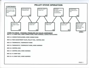

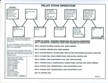

Take a look at these two diagrams and see if you can figure out when your stove goes wrong.

Green light means the firepot has reached 200*, and fuel should start feeding according to the heat you have it set at. Red light comes on when firepot reaches 600*. Would be nice to know step by step actions of the stove, from time you turn tstat up calling for heat. If it just feeds initial feed for start up, and then proceeds or something else. kap
I would almost think both your upper and lower temp switch has failed so the Stove has no idea of the temp. Have u tried unplugging them? Or possibility the board has failed
