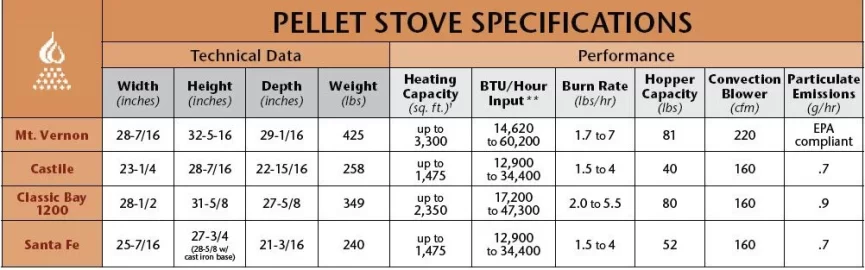

Welcome stark...... got ours about a year ago.....I burn lignetics and only have to touch up the window every 4th day of burning...(however I'm a fussy guy)......, I like the large window and the radiant heat that comes off of it. Hooked the thermostat up to it otherwise on either end of the heating season, it will cook you out on low. Got the 24K gold door and grill kit for extra $$ but stove looks really great in our living room. Has a large hopper that takes (2) - 40 lb bags of pellets = less filling. It's made very solid to a tune of 350 lbs. :-/ installed it myself...was very easy except for the weight....my 20 year old son helped me get it into place along with a hand truck... glad we don't have to move it......
Very few major problems have shown up on this site for this model, I haven't had any yet (touch wood) but one thing I like is that its not too sophisticated technology to be worked on if it was needed. I asked my dealer what he had in his home and he had the same but only the insert model...thats what finally decided it for me. (he sold 4 other makes) Easy to clean, has pull rods to easily clean the heat exchanger tubes (I like that), has a large ash pan. Two fan speeds for each heating setting,(Low, Med & Hi). Bearings are sealed so no lubrication required.......I don't have any negatives right now...... attached a pic of ours and a spec sheet which you may already have...... happy stove hunting....CC :lol:
Click on Pic for close-up...
