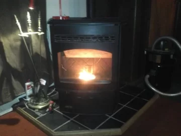

Burn pot has an occasional whistle, guess that tells me that is is burning... Anyway here's a picture so it did happen !!

I really like the way the hearth matches the stove. Funny having the fireplace tools there, although I suppose the broom will come in handy for corralling stray pellets. And, that ash vac is HUGE - it will give you plenty of cleanings before needing to be emptied.

Looks good!!! Yea, they do whistle occasionally. That's a good thing. It took a while to 'persuade' the sheet metal not to rattle. My wife POINTED OUT each little rattle! Geee, I'm lucky to have a QC person right here!!! No, she doesn't read this. :)
Same vac I have. Noisier than heck but works!
