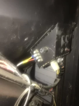

Hey, you think you might be able to do me a favor. I am having the same issue and I was told by a chimney sweep company the thermocouple is bad. The guys took everything apart and left it that way and I have no idea where to connect the wires for the new thermocouple. Would you be able to post a photo of where your wires connect? That would help me immensely!
As you face the stove, open the top rt side panel look for 2 screws on the front Of the box the high low switches are in.
