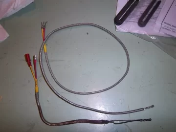

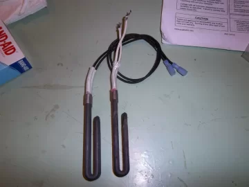

Eureka Fireside had parts on hand. Got me a new Ignigter and a Thermocouple. Both were wrong part even when I brought the parts list to them personally. Picture 1. and 2. [Hearth.com] Quadrafire Castile Pellet stove Nightmare [Hearth.com] Quadrafire Castile Pellet stove Nightmare
Both these cost me $186 bucks! I think I'm going to return all the parts and buy online this seems like price gouging.

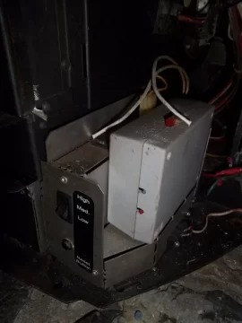

That is the original control box that stove came out with. Newer ones are clear. I am assuming that your igniter is the one with bare ends, and you had ceramic twists to connect? The thermocouple is probably most of your problem with nothing coming on. And motors that are old and set for a while will get stuck. That is why when you spun it, it started. I have had to do that with a few motors. And always make sure you unplug stove before working on it. And always unplug stove when installing or removing the control box, or you run the risk of shorting it out. Exactly where is smoke coming from? kap
It wouldn't hurt to get a gasket for the exhaust fan, so you can remove it and clean in there, if you didn't get to it from inside firebox. kap
I would do a continuity test on the igniter, to see if it is good or not. With the bad thermocouple, nothing will run. No sense buying an igniter if you don't need one. And the one in the pic with the black wires, is the 300 watt igniter. The original 380 watt has the covering like yours. Just noticed that. And you can get igniters on line for about 26.00. kap
