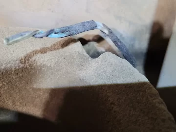

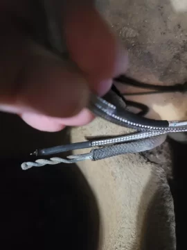

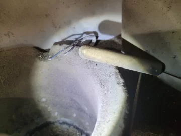

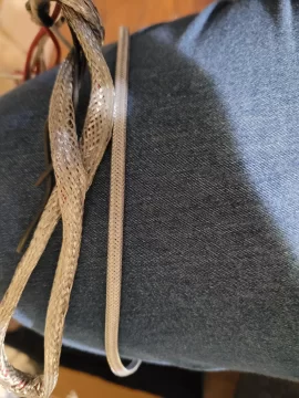

I know how thermocouples are made and how they work. It was from a Quadrafire manual where it suggested to retwist the wires together as a temporary fix. Here's a link and it begins on page 7. file:///C:/Users/tammy/OneDrive/Documents/Quadrafire-1100-Insert-Technical%20Manual.pdf I can attest that it does work, but obviously it is not a long term fix. I have been able to continue using my stove for several days while I wait for the new OEM thermocouple to be delivered. What I discovered when this latest one failed after only 2 days was that this newest thermocouple was made of multi-strand wires, and the older thermocouple was made of 2 heavy gauge single strand wires from the welded tip all the way to the control box. When I replace the crappy one that is currently working because I pulled through more of the extra wire, stripped the coating off, and tightly twisted the wires together, I will get comparison pictures and actually count how many tiny strands of wire was used. It became so brittle from the heat, it just crumbled inside the cover and in my fingers. I had to cut off about 3" to get to undamaged wire. For now though, I'm sharing a photo to show you the difference in sizes. The new one is about 1/3 the weight of the old one. The old wire was so heavy, it was difficult to bend without pliers. The new one, I could easily twist with my fingertips. My burn pot is the older ceramic style and it does not have a holder to support the thermocouple in its protective cover. The old thermocouple wire was sturdy enough that it could be bent and stay in place with the cover, just above the rim of the pot. It was not "hanging". This new one was so limp, it would not support the weight of the cover. The cover had to rest on the edge of the fire pot, which is the position that the manual and videos show it should be positioned. I would speculate that the after market thermocouple you have, that has lasted so long, was better made than what is available today. I sincerely suggest that you start the process of finding a back up for when yours does fail. Then you will understand what I am explaining. I have an OEM thermocouple on order with estimated delivery tomorrow. It might get delayed because my area is dealing with a couple inches of ice from the storms over the weekend. I hope I can keep this one working until then. I am just frustrated that there are manufacturers who are making replacement parts that are nothing at all like the originals. What I was asking for is a reliable supplier who will ensure that they are providing the correct parts, not just ones that someone has stuck a label on with the part number but that has no resemblance at all to the original.
Picture #1 represents size differences between old on left and new on right.
Pic #2 shows the twisted end of the older thermocouple. You can see the weight of the wire and how it is twisted several times.
Pic #3 shows the new one after I removed the cover to inspect it since it was not even sensing the initial temp to start feeding pellets. The wires were still attached at the tip, but had untwisted.
Pic #4 later same day the wires burned through and the welded tip separated.
If you look closely at these pics, you can see the difference in the weight and type of wire. Multi-strand is not going to hold up to the high heat as well as the heavier single strand.
I found a 5th pic that shows a side by side comparison of the twisted part of the wire. Look at the difference! How can the top one be sold as the same part as the bottom one?
