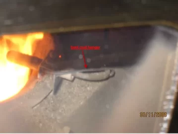

......once you get the new thermocouple in ..... it will heat and cure and maybe pull back from inside the porcelain cover.... this is what I did to keep mine in place so it wouldn't pull back....bent a piece of coat hanger .....cc ;-)
...... click on pic to enlarge and it becomes clearer.......

I wired mine, got tired of pushing it back in ever time I cleaned it.
[Hearth.com] Quadrafire Castile stove not igniting / not feeding
Sils, just curious.....what are those 2 self-tapping screws on the top of the bracket supposed to be doing? The nearest one doesn't even look tight......
the old TC brackets just had a screw down thru to hold the TC cover in place so it didn't fall out. Now they have more of a clamp type holder when you tighten the firepot bolt down it tightens on the TC holder. Looks like he has the old style
