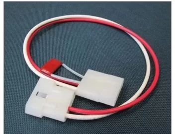

It is the capacitor on the auger wire harness, You should be able to go on line and find a capacitor jumper. They are usually around 14.00. If there are any around. If not, I have some. They quit making them, so now you have to buy a whole new auger motor to fix it. kap
I just checked online, and some places still sell em. kap
I suppose if you know what you are doing, and what capacitor it needs. The one you buy just hooks into place in the wire harness. Look at one anywhere some co. is selling Quad parts..kap
Looks like this. $13 plus delivery...If kap has one to sell it is worth getting. IMO.
