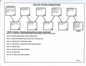

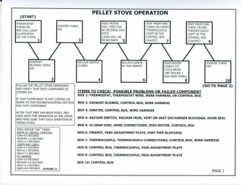

In case this helps....
  • [Hearth.com] Quadrafire CB1200 free standing - smoking the house out.

In this case Snap Disc #1 needs to be replaced or needs to be at a lower temperature so that the convection blower stays on a bit longer. This would allow more of the pellets to be burnt off in the pot so when the snap disc functions, the final cycle should do what it's supposed to.

Understood Bob, but in the logic diagram, there is something missing. The 10 minute shut down cycle shouldn't be initiated by room temperature call. (no more room heat) but by the snap disc saying the stove has cooled down enough. The combustion blower never stops before the convection .blower.
