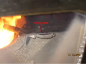

.... click on this pic to see up close what I did with some stiff coat-hanger wire to hold the thermocouple in the ceramic holder... does the job..... the thermocouple wire stiffens over time with being baked and pulls out of the ceramic....not now....cc :)

My sincere thanks for taking the time to answer my question. So far so good.
Gary
