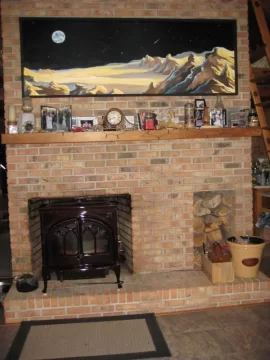

I just installed a woodstove on our hearth extension this past February in much the way you are intending to do. Our extension was only 17", but with the Jotul F600 we bought we were able to slide the stove a few inches into the fireplace opening so that it would sit safely on the hearth extension. You need to know the height of your fireplace opening along with the radius height and width to figure out what stoves would work for you. Here are a couple photos of our set up to give you some ideas.
[Hearth.com] Quality Wood Stoves that are less than 24" in depth & rear-vent? [Hearth.com] Quality Wood Stoves that are less than 24" in depth & rear-vent?
Our fireplace opening is 32" tall and the stove sticks inside the opening about six inches. The legs on the Jotul F600 are 16" wide where they sit on the hearth extension.
Good point. The maximum depth rarely coincides with the maximum height. It's possible the rear part of the stove may fit back inside your fireplace, even though the stove is listed as too tall. To make the most of this, you need to look at the drawings in the manuals, which can be a bit of work.
